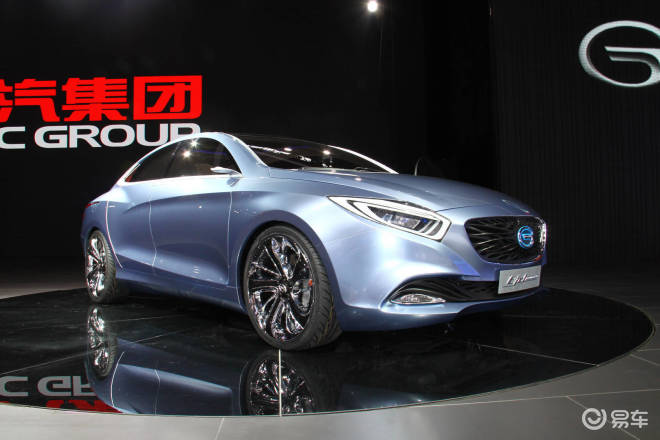

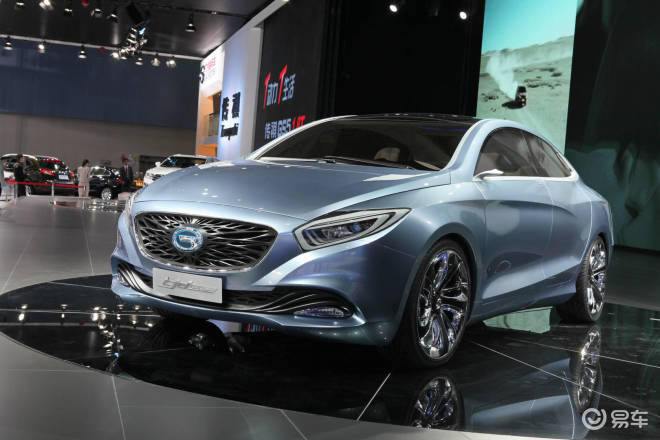

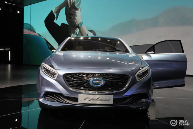

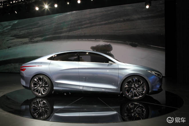

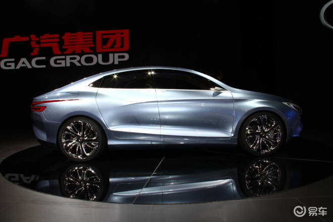

Introduction of Compact NEV E-JET
Compact NEV E-JET,powerful, efficient and green,is a Range-Extended electric car with fashionable and modern appearance, designed by GAC Engineering based on its independently developed brand-new compact passenger vehicle platform. Equipped with a 95 kW (peak) permanent magnet motor and a 13kwh lithium-ion battery pack, E-JET can achieve a top speed of 160kph, an acceleration from 0 to 50kph within 4.5 seconds, and a gradeability higher than 32%. With its excellent energy management strategy and lightweight technology, E-JET can have a pure electric drive range of more than 100km. E-JET uses a 1.0L gasoline engine and a 30 kW PM generator as the range-extender to charge the battery when the battery SOC is low, which extends the total drive range to more than 600km with a fuel consumption of less than 2L/100km (NEDC cycle).
In pure electric drive mode, E-JET has demonstrated the advantage of zero tailpipe emission, low noise and low energy cost. In range-extending mode, comparing to battery-only EVs, there will be no more "range anxiety" thanks to the on-board range-extender, and as well, the vehicle cost is dramatically reduced. As a whole, E-JET works much better than conventional vehicles both in fuel economy and emission.
